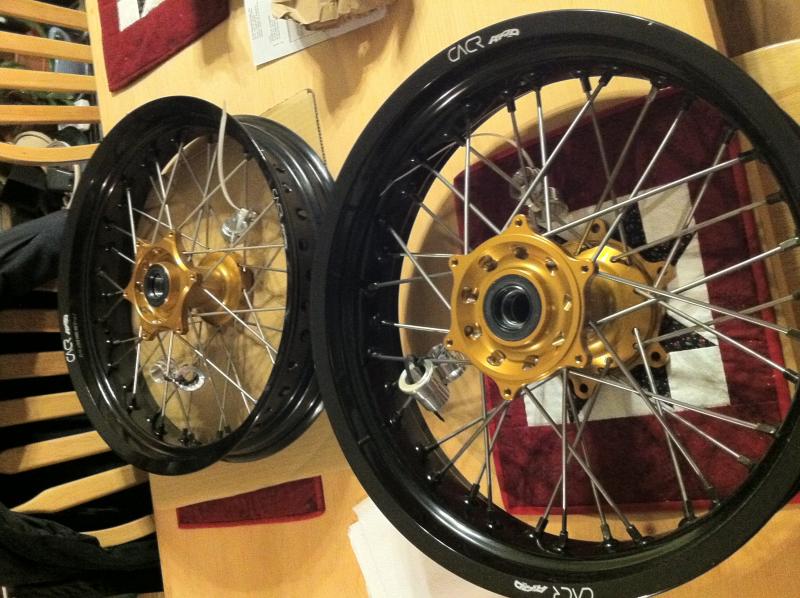

    To provide a BIT more detail... I've been eying a set of Rad MFG wheels they had on prebuilt special for awhile. A set of gold hub, black spoke and rim Sumo jobbers, 4.25" rear, 3.5" front tagged as 'YZ' and no other details. My digging around has shown that Yamaha stuck to the same rotor and hub offsets going all the way back to 1989, they just kept changing axle diameters over the years. So, in theory a set of wheels built for a 2015 YZ450 should be adaptable to my 1992 roach with nothing more than the right spacer kit. Rad MFG confirmed my hunch. So I finally broke down and ordered the wheels. The only real work I'll have to do is track down a custom rear rotor. The bolt pattern matches current, but my machine used larger bolts and a smaller OD. There is a matching rotor out there that'll drop on, but I don't know what it went to... yet.

    The DRZ rear rotor is so close, and yet JUST enough off as to make you think you're doing it wrong when it won't go. It matches all of the right details save for one tiny difference. The bolt hole circumference is 1mm off, 133 for Yam, 134 for Suzuki. D-oh!

    Or, I just order a rear rotor and bolts for an Australian 1992 YZ250 and all is bolt up picture perfect. Why for one year the export YZ switched to a hub with smaller mounting bolts than the years before and after, while the WRs of that range never used that one off setup I dunno. Yamaha eventually switched back to the small bolts but upped the OD for the 99s and later.

    Attached Thumbnails Attached Thumbnails Bring out your dead!-photo-60-jpg
