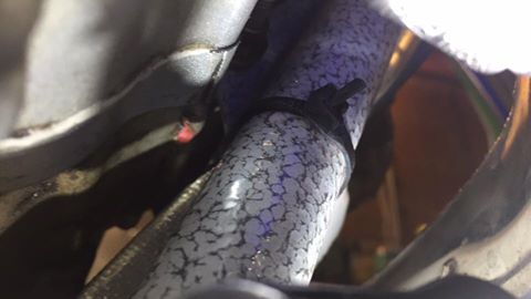

    So... yeah... new top end, lots of new hardware on new top end 'cause I like to make things better as I work, new chain and sprockets for Boxshop, add coolant and... crack in the crankcase.

    seriously, when do you and Patel get a netShow, cause i'm tuning in!
    WTF, happened?

    Given the prior repair work to that motor mount, repair work I did to one case half, the cylinder failure that prompted this rebuild, and the bent frame Kates fixed I suspect the bike had been hit HARD at some point. Some of the repairs were more cosmetic than structural, and as I wring the poor bike's neck on pavement the stresses are causing that prior damage to rear it's ugly head again. Let's not forget the pile of shit this bike started as, it's not like this is a two year old machine that is suddenly going pop, it's had a hard life and I've been trying to deal with it as issues crop up. I'd bet it had been weeping prior to now, I attributed the coolant staining I saw around there when I did my teardown to the cylinder crack. Because in theory I was going to be racing it this weekend and it's a fresh assembly I was being extra cautious going over it, including paper towels on the floor to act as tell-tales for any leaks and well... found one.
    It's not a quick leak, the idiot in me says hang the bike by it's front end, dry and clean that area and just slather on some epoxy but I don't think I could bring myself to race it like that.
    Jb weld
    Especially if you are just mainly running it at Boxshop and with water in it.

    +1 on the jb weld motion. Do it. Do it now.

    Further review showed the seepage to be coming from the base gasket. Research shows this to be a semi-common 'thing' on Yamaha smokers, many suggest using spray gasket prep on base gaskets just as normal maint. (Blech!) So, being the idiot I am, in a time crunch, I did no such thing. I've just fired it up, lit on the 4th kick after sitting apart all winter, and got a lil heat in it to see what happens. If it stays reasonably dry I'll run it.

    Bike survived, no leaks other than some exhaust spooge.
