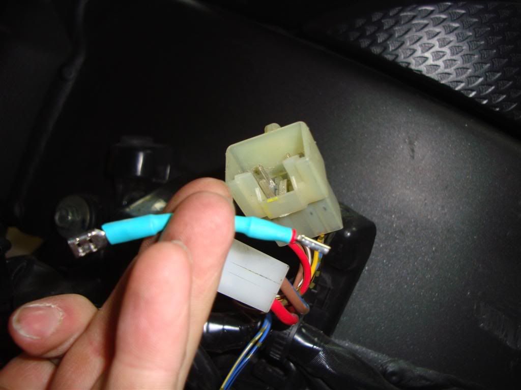

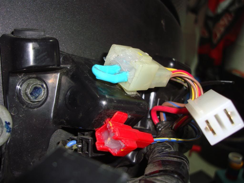

    I'll have to double check exactly which two leads you are supposed to jump in that big connector but the other ones in there are not used, I filled it with silicone. YOu can see pretty clearly which two they are though based on the pictures, the other ones I bent out of the way to ensure no contact and then filled with the silicone.
    The other large-ish connector you need to put push terminals into it, that's where the switch goes.
    Connector I made:
    Good to go, the one on the right is where the switch wires to:

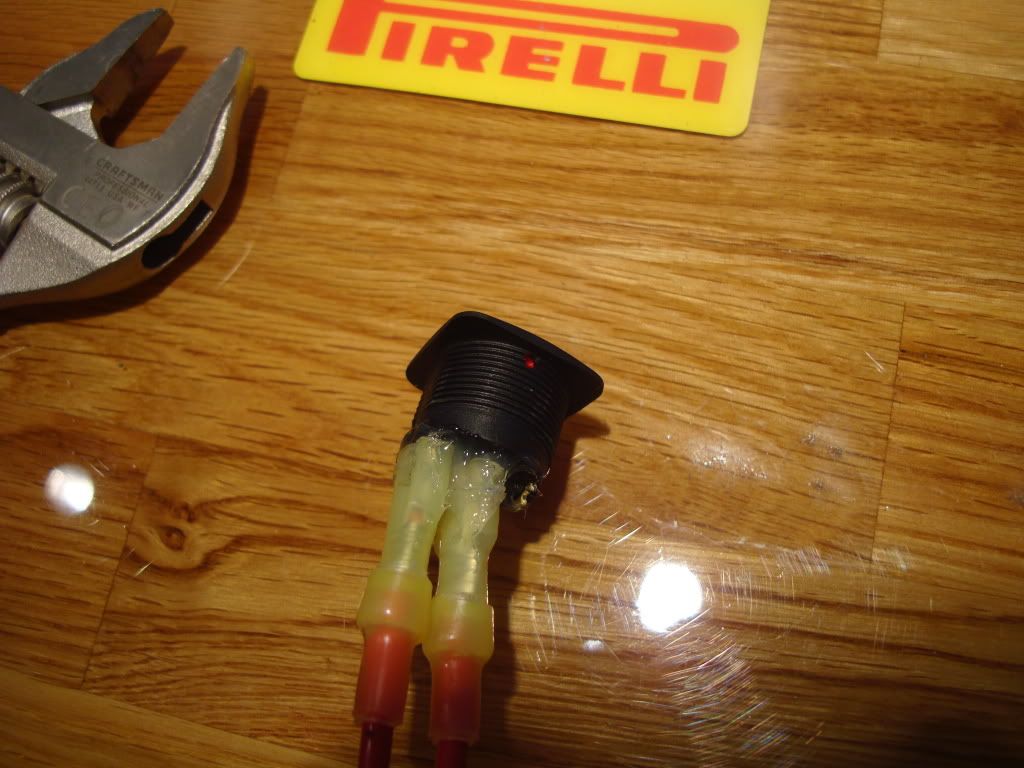

    Here's the switch:

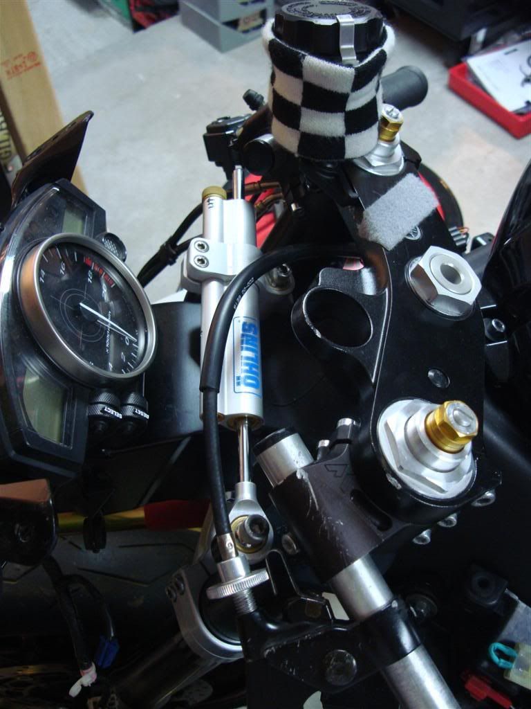

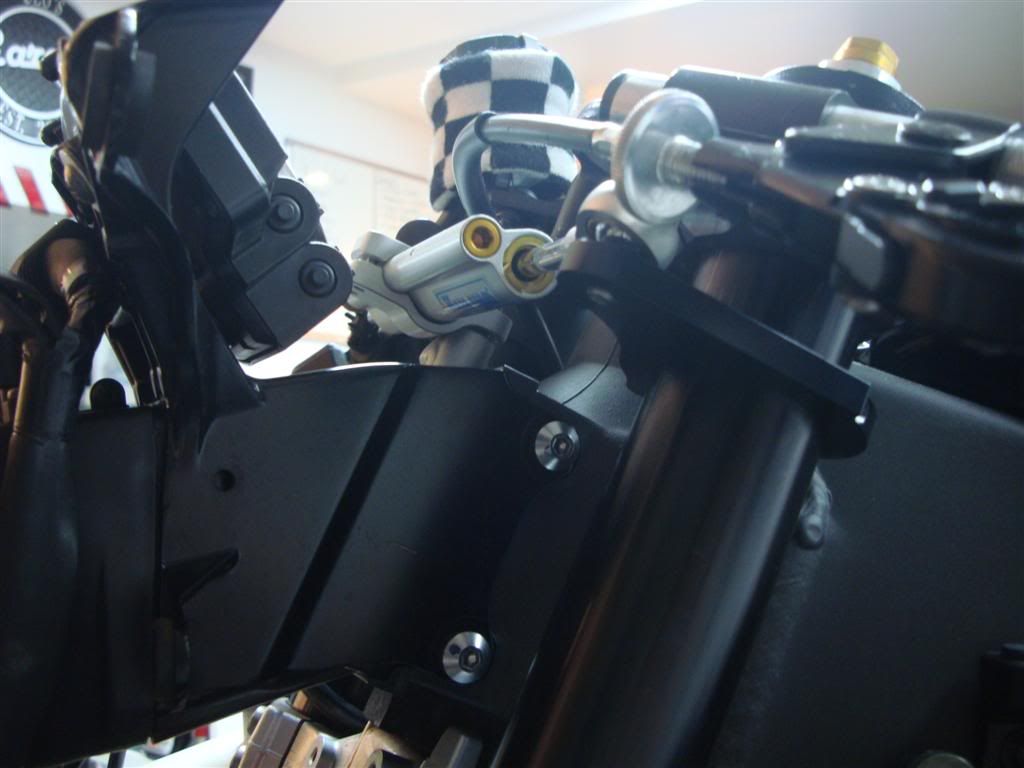

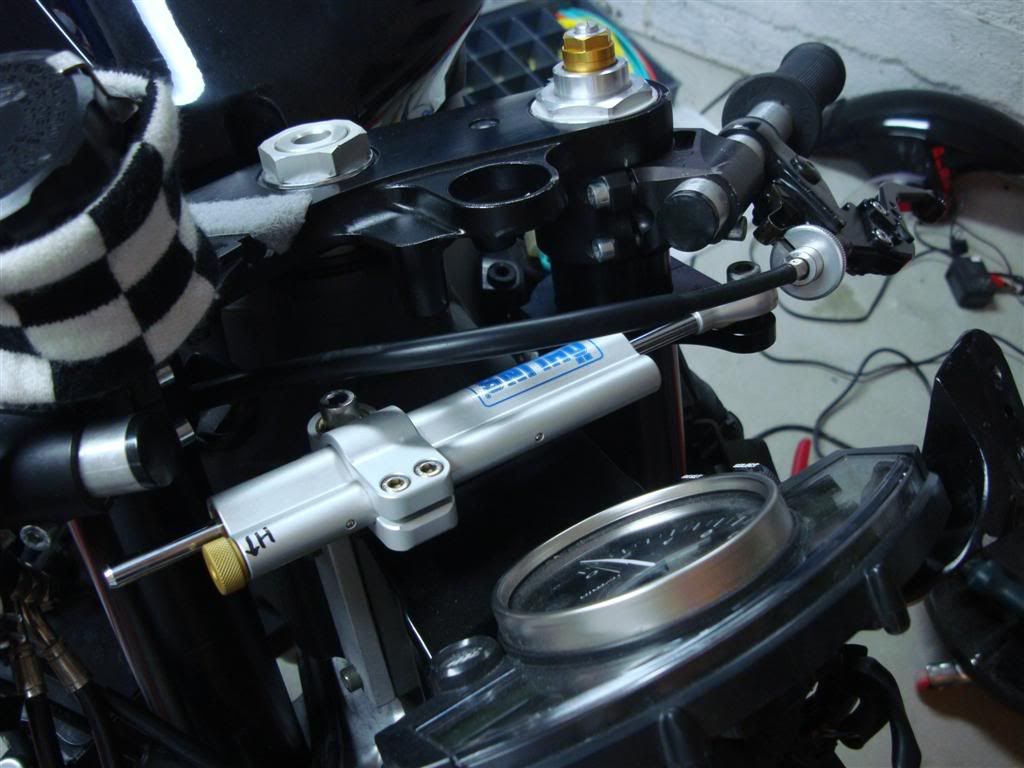

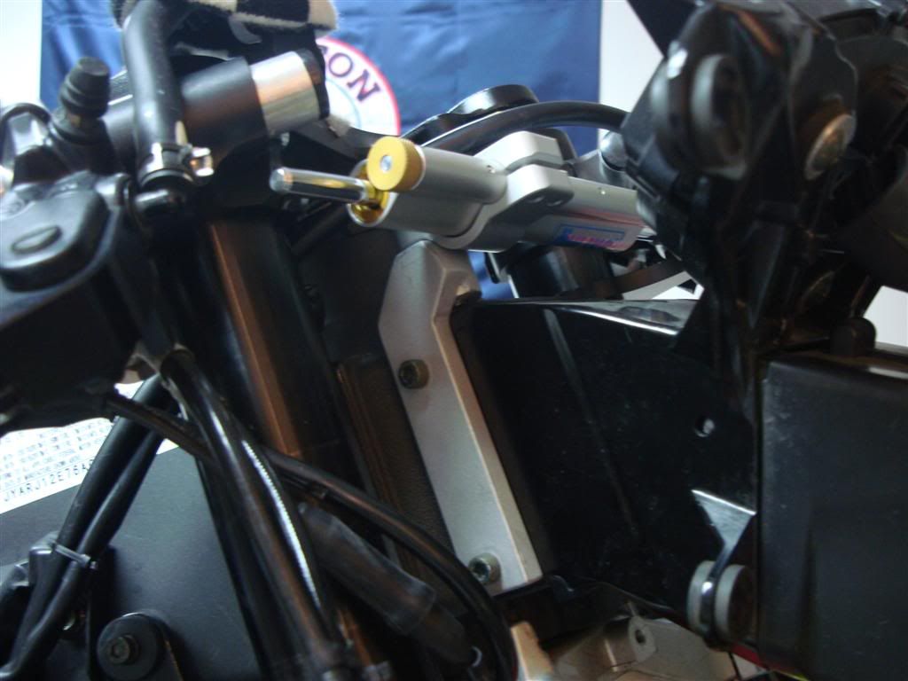

    Damper setup:

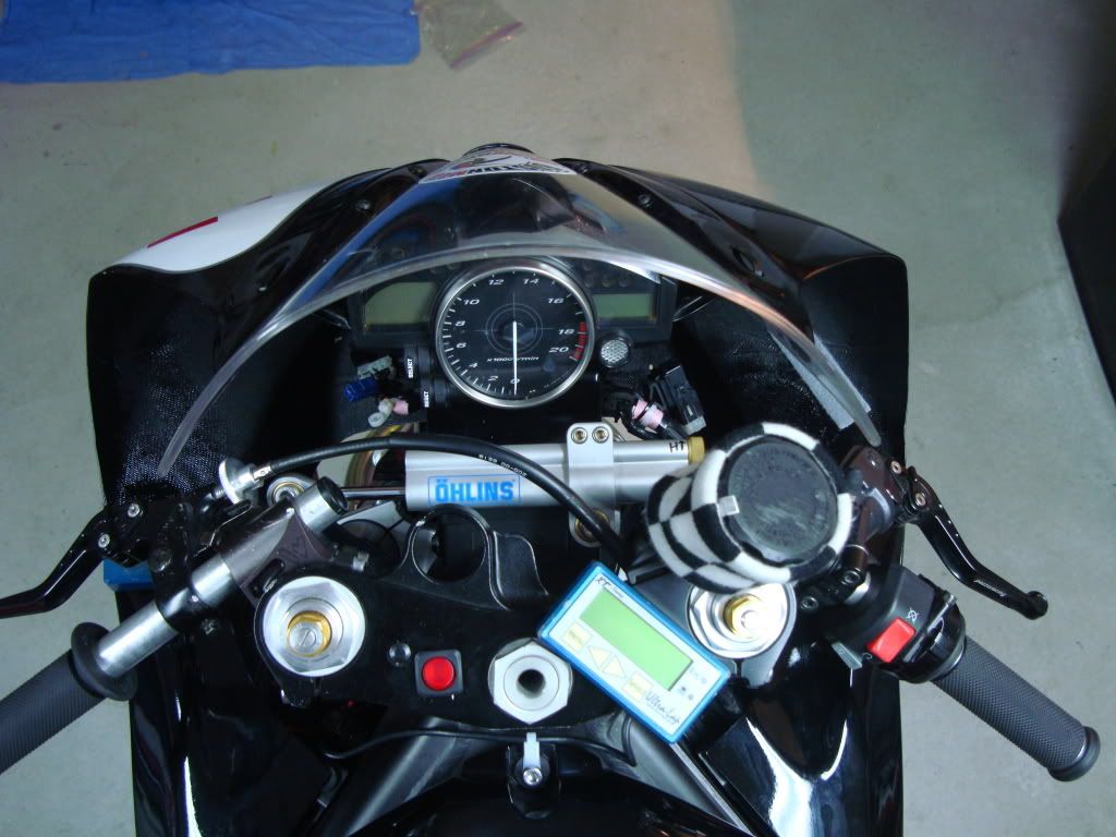

    Top view with switch good to go:
