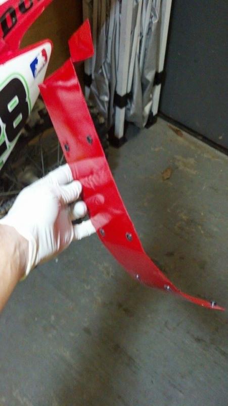

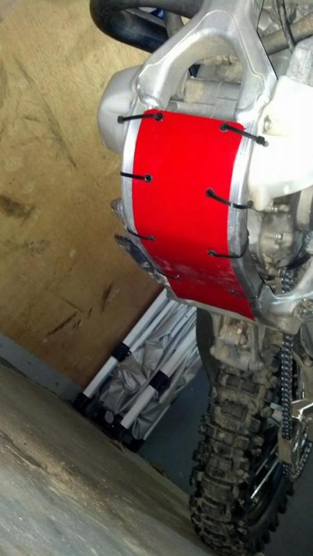

    Making them is the way to go , bought some sheet metal and bent up a couple for my bikes and they work great and still able to use a MX stand. Sumo belly pans + MX stands-4-jpgSumo belly pans + MX stands-1-jpgSumo belly pans + MX stands-2-jpg
    13,839
    Re: Sumo belly pans + MX stands
    That, that passes?! I didn't think of using the frame rails for containment, and I thought ziptie mounting was an instant fail. That said, I think I can replicate that. Do you bother taking yours off for tech or is your drain plug easily visible? (Mine's a PITA to find even sans skid plate.)

    That, that passes?!
    Yeah, that's what I'm curious about.....
    I'm also looking at it and thinking if I did something similar, some caulking to the frame rails would make it "oil tight" and there are things that could be used instead of zip-ties (like hose clamps) since the rule book specifically calls those out as not being of "workmanship quality"....

    Drin plugs are visible on a CRF so no need to remove it on a
