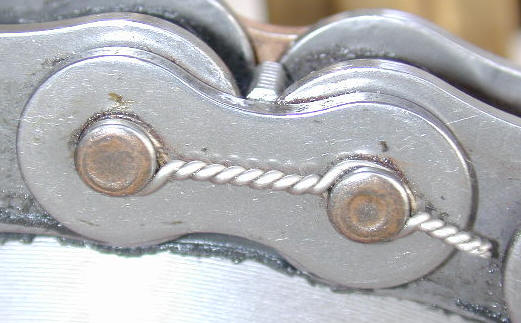

    Not to highjack the original thread but...clip style master vs rivet style. As i don't have a chain tool it requires a trip to the shop or at least trying to borrow a tool. I HATE borrowing tools. Any bad experience with clip type? I do a bunch of track days.
    GSXR750 GS650 Street Tracker
    39,276
    Re: chain & sprockets: EK vs. JT/DID vs. Drivesystems
    Quote Originally Posted by FAST GSXR750 View Post
    Some people use safety wire instead of a clip, like so:
    Attachment 37326 or chain & sprockets: EK vs. JT/DID vs. Drivesystems-50766d1345607259-chain-pop-disconnect-fail
    Others use a dab of silicone on the clip to help security, like so:
    Attachment 37325
    Others still don't do a damn thing... like me. I just check it periodically but I've never had a problem (DID ERV3)

    I'd only use a rivet type but that's just me. if you're worried put the clip type on and bring a rivet type to the track. I'm sure someone will have a tool you can use. post up before you go asking someone to bring one. I can always bring mine if we're gonna be at the same days.
