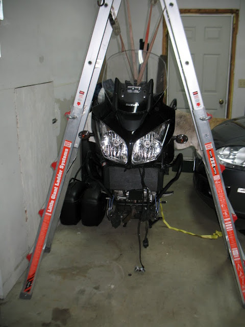

    Ok going to be replacing by fork seals but have no clue how to keep the front of the bike elevated once I remove the forks. Any ideas?

    front stand that lifts from the triple clamp. or use tie downs attached to some rafters to lift the bike by the triple clamps
    That's how I do it.
    16,728
    Re: changing fork seals...how do i...?
    Per a recommendation here, I used an A-frame ladder:
    changing fork seals...how do i...?-img_2946-jpg
    It worked okay. But the ladder was always in the way when dicking with the forks.
    I wound up with two heavy duty eye bolts in my ceiling. Much easier.
    I hope the eye bolts went into joists and not strapping...
    16,728
    Yes, of course. The main beam going down the gut of the garage. The ones the lally columns support.
