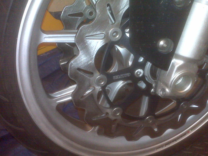

cleaned the rotors with 60-grit sand paper. cleaned the wheel
Attachment 29820

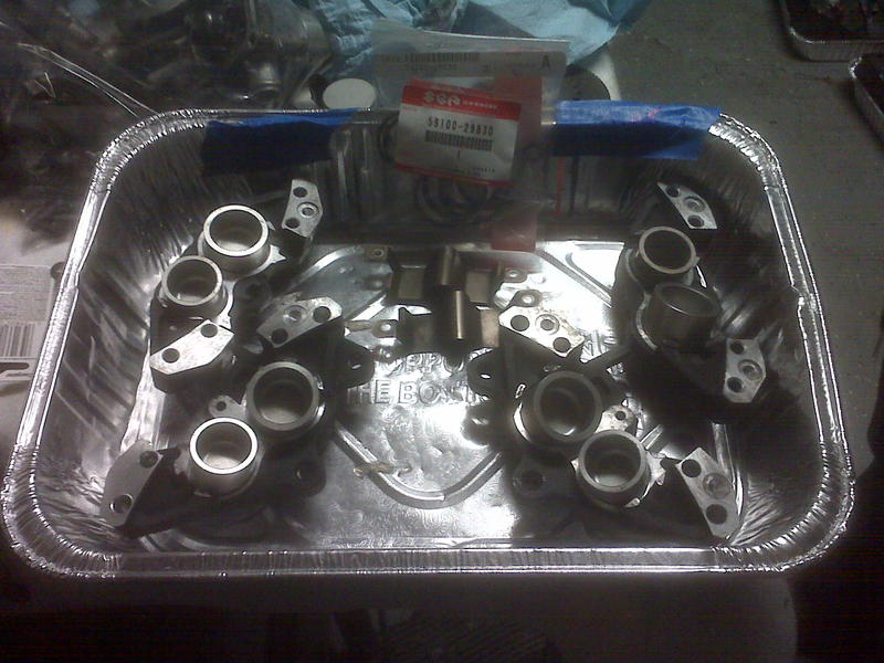

front caliper rebuild. everything thoroughly cleaned & replaced all the seals. found out that I actually cracked the right one. ended up replacing that one.
Attachment 29825
all new stainless and pre-drilled hardware from Pro-Bolt. Have a new set of Performance Friction pads that I'll put in Sunday when I install the calipers back on.
Attachment 29826 Attachment 29827 Attachment 29828

How hard was the Caliper rebuild?
Re: The (not so) Great Gixxer Rebuild
Quote:
Originally Posted by
scubasteveRR
tricky thing is getting the pistons out. we used an air compressor to pop out the 1st piston out. then used a c-clamp to hold the 1st piston back in, and forcing the 2nd piston to pop out.
then just thoroughly clean with a brake cleaner & a small wire brush. make sure you dry with air. the new seals popped right back in. lube the seals with some brake fluid before installing the pistons back in. check your pistons for scratches before re-installing.
also remember to keep everything labeled for right & left calipers.

1 Attachment(s)
pads and calipers installed last night
Attachment 29829
