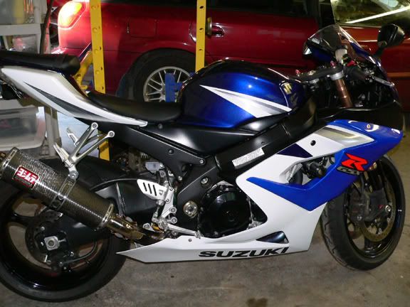

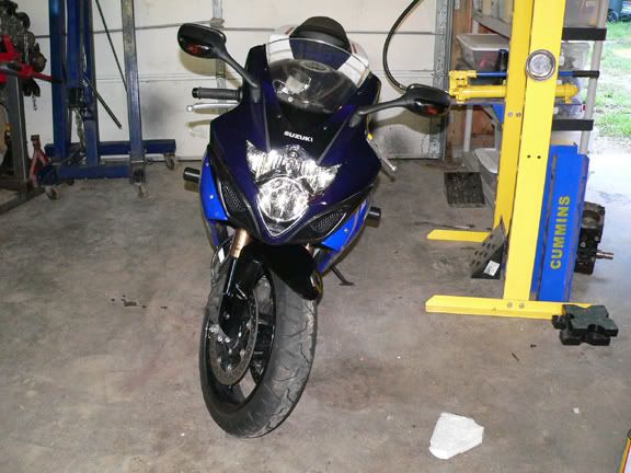

    Some pics eh?
    And yes! the Bstones on there definitely blow. As soon as I get a chance I'm going to pull the powers off my 954 and swap them on here. I always liked the pilot powers and I have a 1k set just waiting for some more use.
    Didn't realize the slipper was adjustable, never had one before.. So far it hasn't slipped on me (that I've noticed).
