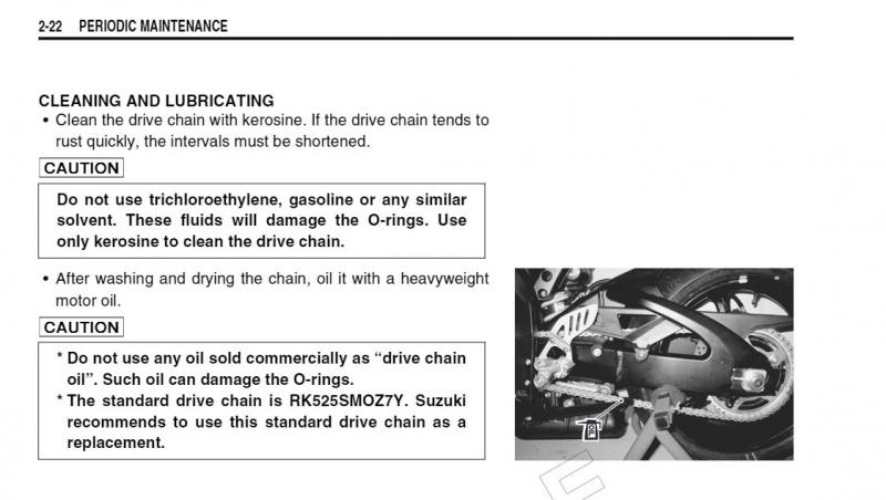

    And easy on the Kero, use WD40 instead.
    it says differently in the Suzuki service manual
    Need knowledgeable mechanic - bike won't move in any gear-chain-jpg

    Isn't one of the main components of wd40 kerosene? Why would you stay away from a "purer" cleaning agent?
    There was a "test" done by motorcyclist magazine where they soaked o rings for a period of time. O rings submerged in Kerosene and wd40 looked identical while other cleaners deteriorated/disintegrated the o rings.

    Maybe I was thinking gasoline vs kero.
    Heh, that suzuki manual says to use heavyweight motor oil. Yeah, good idea, Suzuki!
