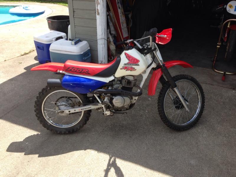

    So I picked up this you from Garandman a few weeks ago
    Paging Kurlon - XR100R-imageuploadedbytapatalk1404918198-614960-jpg
    A basically just two issues (we talked about pre sale) are it smokes until it warms up and it runs a bit rough and dies sometimes off choke. Top end could use a refresh, I'm thinking while I'm there, is it worth it to do a big bore kit, maybe more? I should add, I'm 6'3" 235 lbs, not convinced an extra pony or 2 is going to make a world of difference with me in the saddle.
    Also, a bit of guidance on the cheapest route to 'tard this thing? Other than maybe teaching the girl (5'3" 115 lbs, think it's perfect for her!) to ride dirt on it, this is going to be a pit bike, tool around the neighborhood toy.
