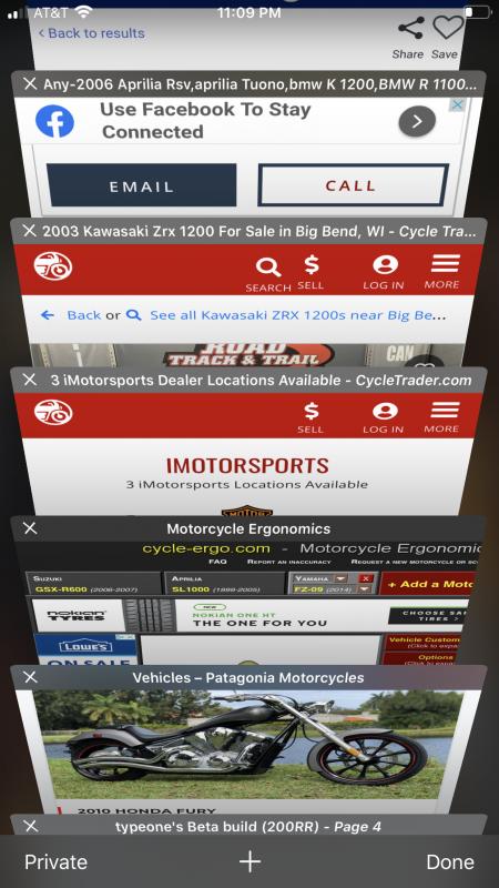

    Meanwhile, look at all the windows I have open trying to FIND a bike
