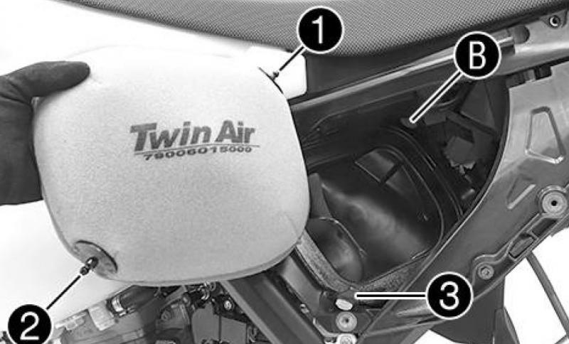

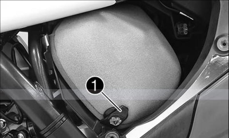

    new air filter setup, curious how that will be. previous design had a thin handle that clipped under pressure over the filter, new design has a clip or grommet on each side.
    Looks extremely similar to if not the same as the KTM/Husqvarna/Gas Gas air filter set up
    interesting, i guess it will hold up then (?) the tabs seem... not sturdy ...but i haven't removed the filter yet.

    Not to clutter up this beautiful bike post with pics of ugly Husqvarna air boxes but here is what they look like.
