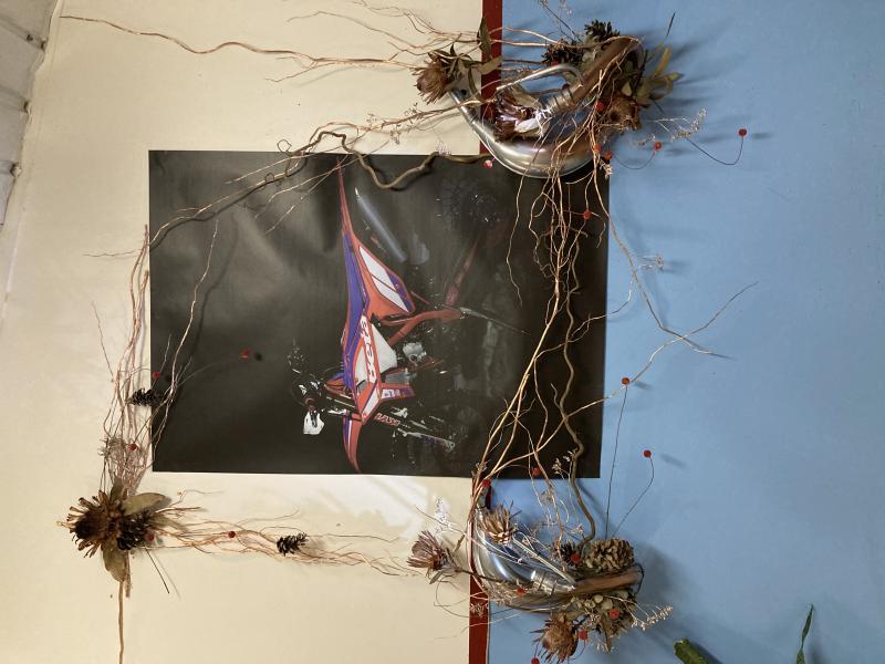

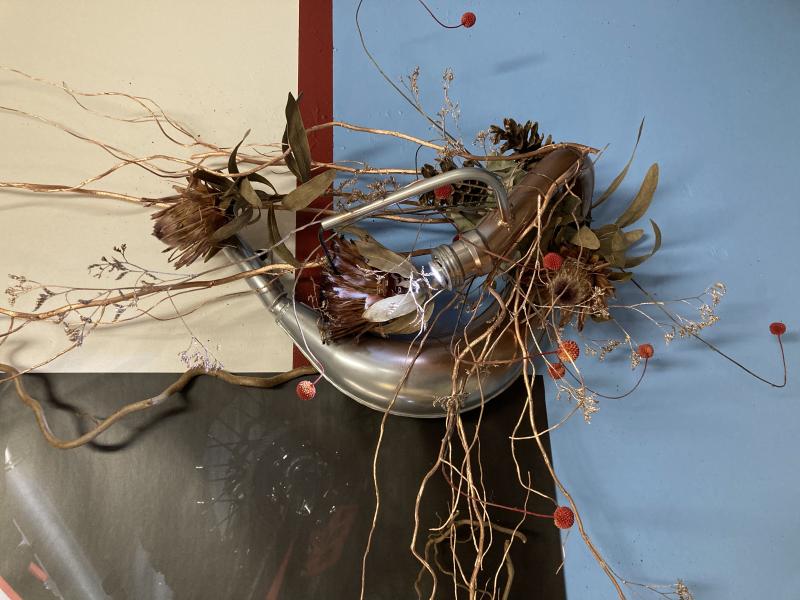

    Clinton, I was traveling and visited my buddy in Finland that owns a Beta franchise. I thought of you and this thread when I saw the wall art in the showroom. Pretty creative, there’s LED lights coming out of the pipes that light up the poster
    typeone's Beta build (200RR)-be85738a-1738-4a63-a8c7-d3596bee19f0
    typeone's Beta build (200RR)-eadc2841-2b96-442a-8828-15793c3e1176
    Edit: not sure why the pictures are sideways
    that's wild! thanks for sharing, Mark ... i knew you had a few friends into Beta over there, is the franchise a new endeavor that grew from just being riders?
    would be cool to see that display lit up ... the 'bleed pipe' or extra chamber thingie (thin tube just after header inlet) is intriguing. know what that does or where it goes? looks like a 125cc pipe (?)
    I’ll have to ask about the thin tube, that’s where the wire goes in that powers the lights now.. lol
    Yes, he started out just riding, then started selling parts, then bikes. There 3 or 4 on his race team, they actually just got back from Rome the week prior to my trip there. They were all riding Xtrainers there
