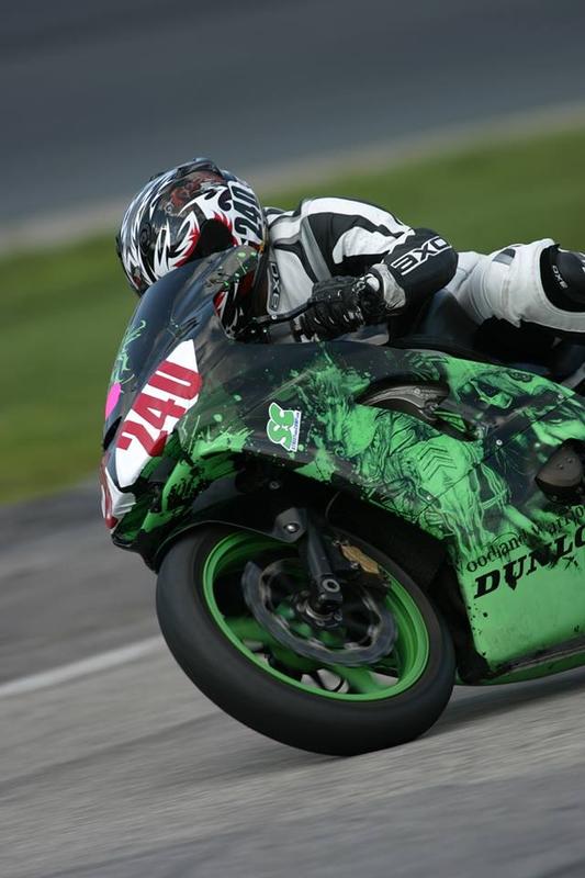

    Thank you all for your help on this issue. Im convinced i found what was 70% the cause of my crash. I was going over some of the John Owens photos from the prior track day and in this photo and a few other it looks like my forks were definitely bottoming out. (Zoom in to front wheel fender and upper fairing) This photo is in turn 12 or 1a (can't tell from photo) and as you all can see my fender is right up against my upper fairing. In neither of these turns am i ever hard on the brakes. My thoughts: if its getting that far on less intense corners i'm almost positive it was over the limit in 3 where i am definitely hard on the brakes almost to the apex. Thanks all again. My crash going in turn 3 last round. Open for criticism and helpful advice-zx9r-forks-bottomed-12a-jpg
