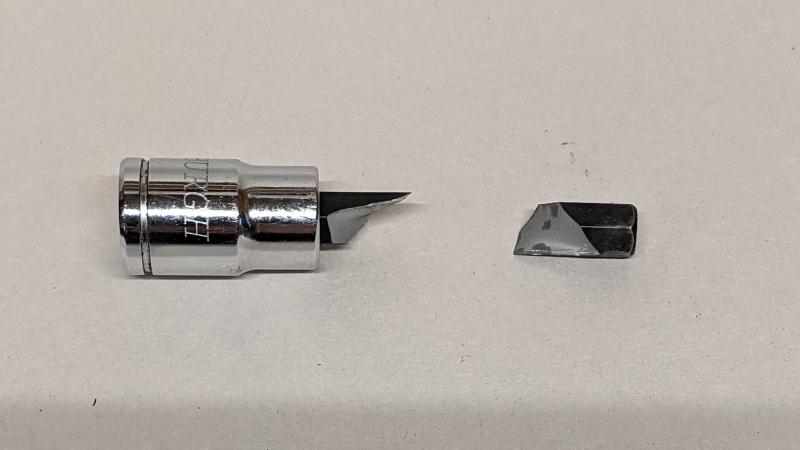

    Made it to 70 foot-pounds but snapped on its way up to 92.

    zoomed in and looked closer, what are those dark spots on the break ? defects? cracks?

    Closer detail:
    Harbor Freight tools that DON'T suck-pxl_20250323_192530279-1-jpg
    Glad we're having this conversation. Discovered operator error.
    The application is the rear axle nut on a ZX1000. My bendy-bar deflection torque wrench only goes to 60 nm, so I went and got my clicker. I re-checked the specs, and thought I read 98 foot-pounds. The spec is 98 Newton meters, which is 72 foot-pounds.
    Ooops.
    The snapped hex probably saved me from a very, very large repair expense.
