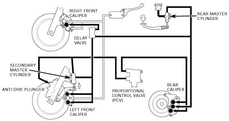

    Re: Soft brakes after bleed
    Try it with this...
    Soft brakes after bleed-original-jpg
    As you know, I know shit about V-Stroms...
    There has been a long standing issue with "some" GL Brake systems (which have been around for more than a dozen years) which recently a solution was discovered for.
    Turns out there is a brake line that runs up and over the engine. In some cases when air gets trapped in this particular line it can't (at least easily) be bled out as it is at a local "high point" in the system. A guy, having fought with this for years, found a fitting on this line, cracked the fitting open (just a bit) and was able to bleed air from this line after having repeatedly tried to bleed the system per the factory recommendation. Just a little psssssst, cleared up a problem he'd been chasing forever.
    I'm not saying the V-Strom has anything like this or that it is your problem. Something to look for.
