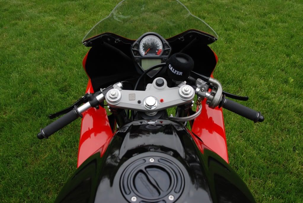

Crap. Some guys over on SVRider pointed out rules in certain organizations only allow kill switches on the handlebars.
CCS has this rule in its book:
5.2.2 All machines must have an operational handlebar mounted kill switch
or button. This switch must be easily identifiable by color or emblem for use
by safety crew members.
Do you think tech will have an issue with my triple-mounted one, which is clearly labeled?

If you have a two-digit number then, no, not at all.
Quite honestly Chuck, my thing has always been "why risk it?" I mean, sure you may get thru Loudon tech but surely you can't reliably depend on that happening every weekend and that is just based on the paragraph you posted from the rule book...that and are you really planning on limiting your race program to one track because of a stupid kill switch? Doesn't seem worth it at all, IMO.
Maybe save that switch position for pit lights if you ever decide to wire something like that up and go endurance racing....or maybe a Dukes of Hazzard horn or something
Not for nothing but if I walked over to your bike with that current setup, I'd be asking myself "do I need to flip the IGN then hit the KILL or what the hell is going on here??"
Just an outsider's perspective.

Your switches might be OK but that clean bike and shiny paint are going to suck you into the 1a tires like nobody's business.
LRRS EX #7
Low Down Racing
I would have just left the handlebar switch but I see nothing wrong with your set up. I kinda like it a little better with the colors too, makes them stand out a little better and would be easy to identify them.
