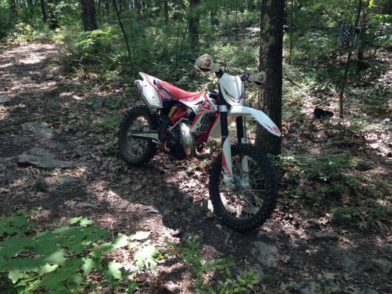

    re: typeone's Beta build (250RR)
    in it's natural habitat, upper Hodges, 1hr in...
    typeone's Beta build (250RR)-imageuploadedbytapatalk1404328233-541924-jpg

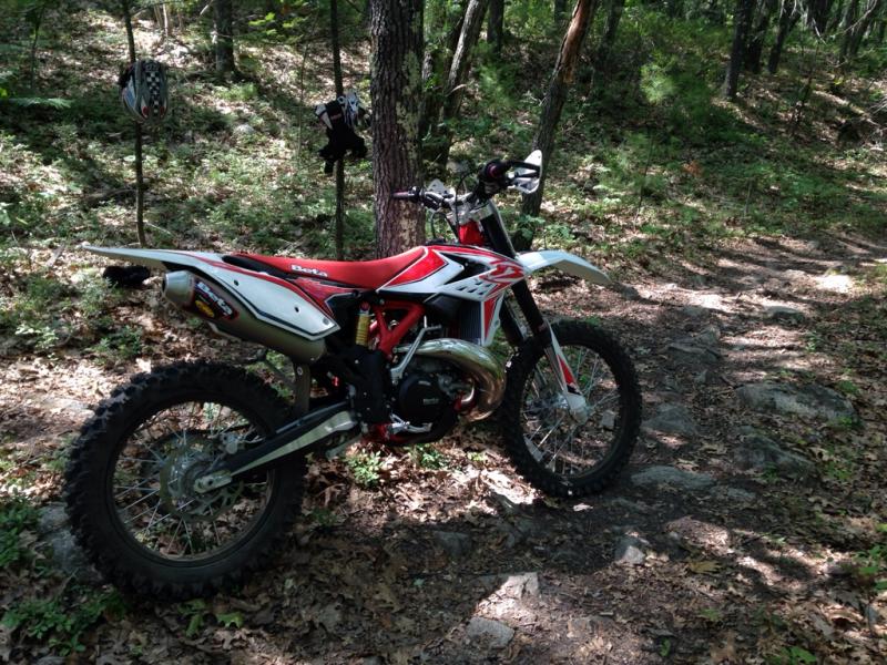

    so far I've noticed, the motor has insane, smooth power, lots of vibes, front is stiff and I can't get it to turn quick. went 3 clicks out on forks, little better in the chop but I will need to try to raise the forks and see if it turns better. my WR rode on telepathic rails. (w/3 yrs of tuning)
