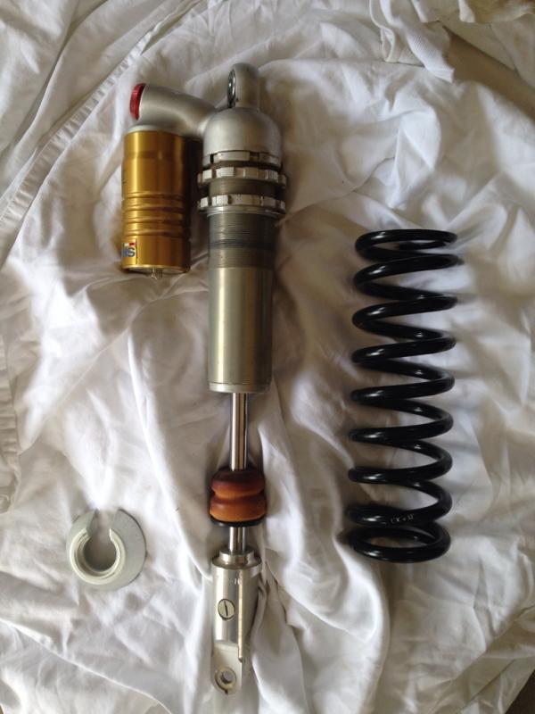

    testing out a 5.2kg tomorrow...

    You got a spring press, or can you back off the preload enough to get the collar off??

    nope. only need to back off preload ring. don't even need to remove the subframe. remove all 4 bolts, jockey entire unit to the side and shock slides right out.
    nice bike to work on so far.
