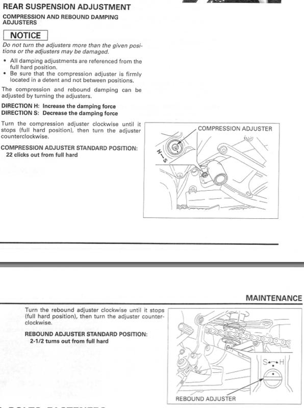

    Extensive Googling has sadly not yielded an answer to this one. The 2007 600RR has what looks like a piggyback reservoir for the stock rear shock, but there's a plate with no knobs where I'd expect the clickers to be. The plate does have a _very_ small hole in the center...perhaps for pulling the plate off, or fitting a special adjustment tool through?

    I was looking in the wrong spot...
    how to adjust (stock) rear shock on 2007 600RR?-screen-shot-2012-04-19-a
