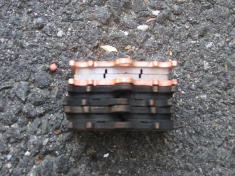

    Day 4:
    Picked up my new SBS brake pads for the front from Bettencourts
    The (not so) Great Gixxer Rebuild-2008-08-21-2-jpg
    after taking the 2 bolts off for the caliper, remove this hex nut with a 5mm allen wrench. this is the pin that holds the 2 pads in the caliper
    The (not so) Great Gixxer Rebuild-2008-08-21-3-jpg
    install the new pads, and put the pin back in the caliper to hold the pads. if you used your front brakes before taking the caliper out, your pads will probably look close together like this.
    The (not so) Great Gixxer Rebuild-2008-08-21-4-jpg
    very carefully, get a flat head screwdriver between the pads and pry them apart. this will make it easy to get the caliper back on the rotor.
    The (not so) Great Gixxer Rebuild-2008-10-02-5-jpg

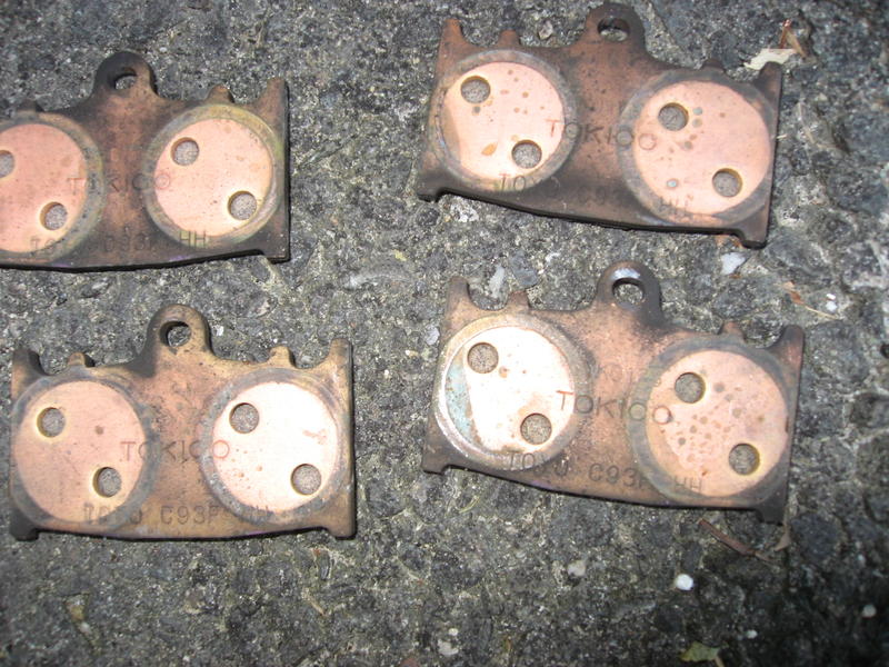

    here's the view of the old & new pads
    The (not so) Great Gixxer Rebuild-2008-08-21-6-jpg The (not so) Great Gixxer Rebuild-2008-08-21-8-jpg The (not so) Great Gixxer Rebuild-2008-08-21-9-jpg
    put the 2 caliper bolts back in with a 12mm socket and torque them to 18.1 ft/lbs (this one's for you garage guy)
    The (not so) Great Gixxer Rebuild-2008-08-21-10-jpg
    the old stock Tokico pads
    The (not so) Great Gixxer Rebuild-2008-08-21-11-jpg
    Make sure you pump your front brakes before riding. I broke the new pads in as suggested by Degsy. Go 30MPH down the street, and go to an almost complete stop. Repeat 5-6 times.

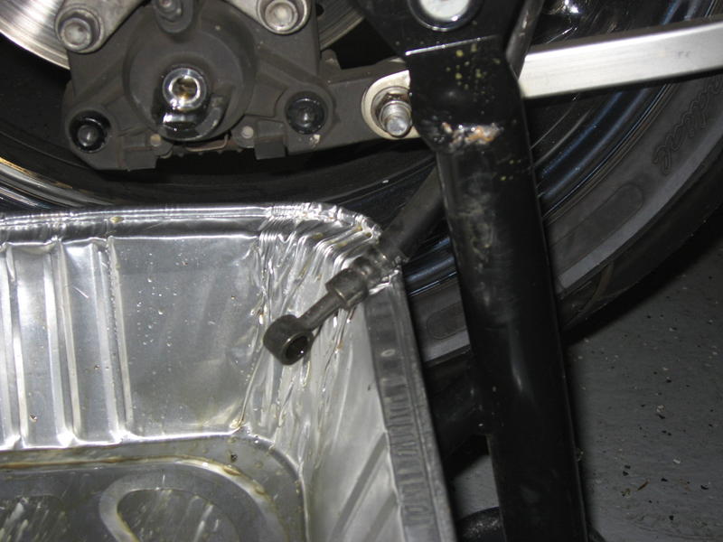

    After I finished the pads in the driveway, I rode to Degsy's to do the rear brake lines.
    Remove the brackets holding the line to the swingarm with an 8mm socket & take the top cover off the rear brake reservoir.
    The (not so) Great Gixxer Rebuild-2008-08-21-12-jpg
    After loosening the bolt on the caliper with a 12mm socket, drain the old brake fluid into a pan & pump the rear brake.
    The (not so) Great Gixxer Rebuild-2008-08-21-13-jpg
    Once all the old fluid is gone, remove the 12mm bolt off the brake line at the reservoir & take the line off the bike.
    The new brake lines came with new crush washers & 14mm bolts. Make sure to use a new crush washer on both sides of the brake line & then torque the bolts to 16.5 ft/lbs.
    Reuse the rubber grommets from the OEM brake lines & install them on the new lines. Install the brackets that hold the lines to the swingarm.
    The (not so) Great Gixxer Rebuild-2008-08-21-13-jpg The (not so) Great Gixxer Rebuild-2008-08-21-14-jpg
    Once everything is bolted back up, fill the rear reservoir with new DOT4 brake fluid and start bleeding rear brake.
    The (not so) Great Gixxer Rebuild-2008-08-21-15-jpg
    once all the air pockets are gone, you're good to go

    just FYI but I would recommend pushing the caliper pistons back out without the pads in. Like you said its fine if you are very careful pushing on the new pads but its a good idea to push them out with the old junk pads in or without pads at all.

    ya i thought of that when i bolted everything back in. then i got lazy and did it with the new pads in anyways

    got one better for you - if you can let the pads sandwich together and sit on one side of pistons, then you can pry from the backside of the pads - at least thats what i can do on my 636 - then no chunks taken out of your pads
    nice work jimbo, did you leave some air in the rear line to leave the brake a bit soft? just wondering as i know how you love doing stand-up wheelies and how you always cover your rear brake.

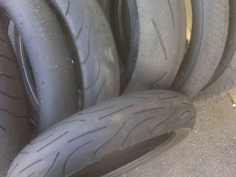

    last update for this thread. my bike is now ready for that 225 mile ride in NH i''m doing next weekend. Got my new A* boots and SPIDI Penta gloves, and now it's time for a new(er) tire. My front tire was done, so swapped it out for another one with better tread.
    Old vs New - Michelin Pilot Power 120 tire (non 2CT)
    The (not so) Great Gixxer Rebuild-aug-31-2008-nhms-004-a
    took the front wheel off and had Boston Moto mount the tire for me. thanks again guys
    The (not so) Great Gixxer Rebuild-aug-31-2008-nhms-006-a
    the tire wasnt new, but was very slippery on the ride home form NHMS. Took a good day of riding for it to feel sticky again. Thanks everyone for their comments & feedback on this thread.
