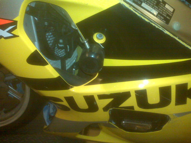

    new Frame Sliders installed. fairing already cut
    The (not so) Great Gixxer Rebuild-2010-01-17-frame-sliders
