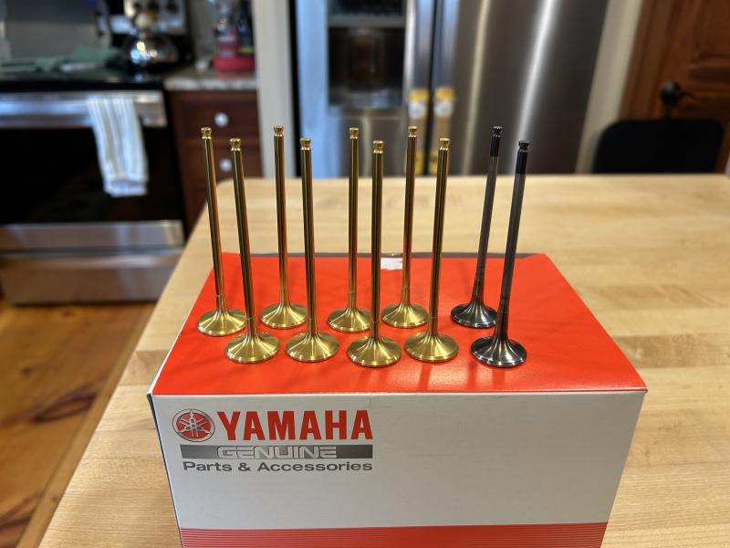

    And they arrived a day early! Just organized all the parts and will drop everything off at the shop in the morning.
    Bad decisions were made today..-img_9720-jpg

    Looking at the valves I'm assuming the original ones are the greyish one? Was a different alloy used or some sort of coating applied the the new ones?
    James
  19. #369
    14,887
    Re: Bad decisions were made today..
    Yes, the grayish ones are the originals. The new valves have a coating on them, that most of it will likely burn off. If you look closely at the two originals, you’ll see the oem coating on the tops of the valves where keepers are
