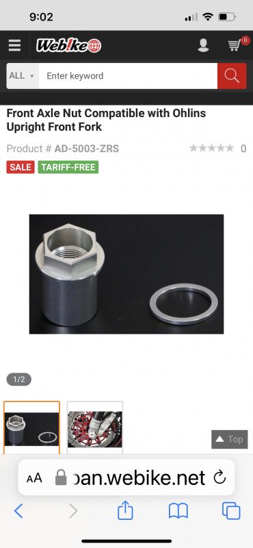

    14,887
    Re: Bad decisions were made today..
    Bad decisions were made today..-img_6721-jpg
    One part missing that I’m having issues finding, which I’m guessing is an Ohlins part? The piece I need, looks like the part in the picture, but the size specs are not what fits my bike. It’s basically a spacer sleeve that slides in the fork bottom, and the axle threads into it. I’m sure I can have it made, but I’m hoping for the easy route and being able to buy one. Has anyone seen something like this available to buy? For reference, the sleeve length is 44.86mm and the OD of the sleeve is 32mm
