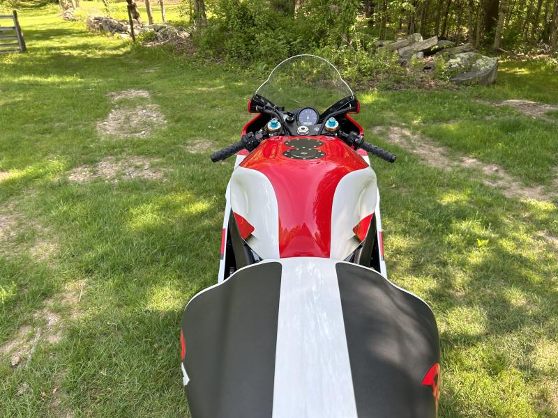

    Tail section showed up today… along with the extra set of cowlings and another fuel tank. I had to buy the whole set just to get the tail section. The only parts of the body I’m still missing are the front fender, and a seat.
    I forgot how big and bubbly the late 90’s era bikes were. It’s starting to look like a complete bike.

    I had to get it out in the sunlight.
    Bad decisions were made today..-img_6628-jpg
    Bad decisions were made today..-img_6635-jpg
    Bad decisions were made today..-img_6631-jpg
    Bad decisions were made today..-img_6627-jpg
    8 Not allowed! Not allowed!
  22. #97
    11,966
    Re: Bad decisions were made today..
    Gawdddd those headlights are fookin hawt!!
    They literally make the bike. Really coming along Mark!
