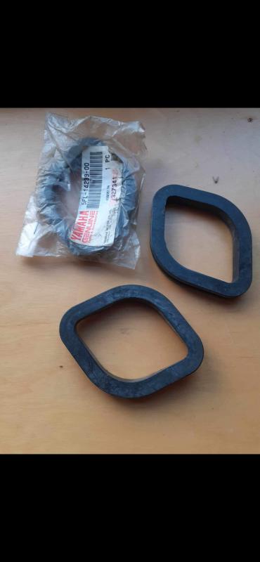

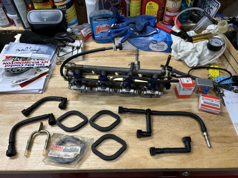

    The elusive diamond shaped gaskets, have been found
    It’ll be an expensive bill for the parts coming, but should be the last of it.
    I’ve got all the pressure fuel lines coming, the 4 diamond airbox gaskets, and a new set of throttle bodies. The throttle bodies I only need the 4 fuel injectors from, but having spare parts is a good thing I guess.

    Let the fun start, question is, will it run?
    The remaining chain guard parts are also on their way.

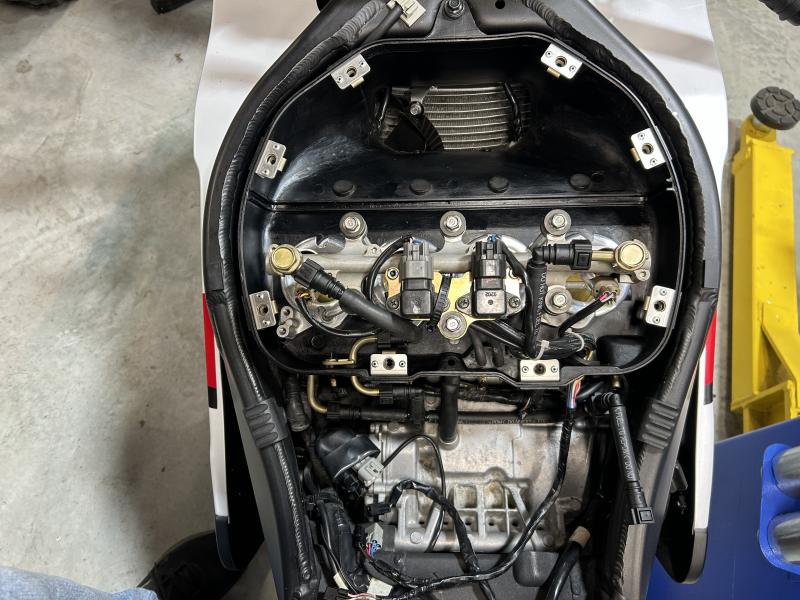

    Spent a little time working on the bike this evening. Replaced the four primary fuel injectors, cleaned the fuel rails, put all the new gaskets and sensors in the airbox, installed the new fuel lines, and cleaned and installed the secondary shower injectors.
    No more codes on the dash now that everything is hooked up properly.
    I need to clean the inside of the fuel tank, put some fresh fuel in it, and see if it runs.
    Bad decisions were made today..-img_8780-jpg
    Bad decisions were made today..-img_8782-jpg
    Jesus Christ man. Don't throw on a sexy little number and then fall a sleep! We need this.
